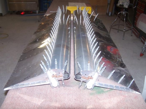

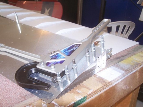

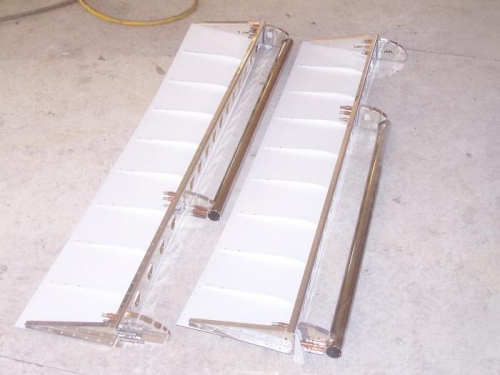

Today I clecoed the botto skins to the spar and ribs. I final drilled #40 the holes common to the ribs and the skins. Then I removed the skins and deburred and dimpled the skins and ribs. Next I temporarily riveted the 2nd and 5th holes from the spar on both ribs/skins to attach the skins to the spar/rib assembly. Next I buffed the flanges on the nose ribs so they wouldn'tdent the leading edge skins. Next I clecoed the 1004L, R ribs to the counterbalance and then to the spars. Then I clecoed the 1015R,L ribs to the spar. Finally I clecoed the nose skin to the bottom spar flanges, then to the top skin and flanges.
Temporarily riveting the bottom skins to the spar assemblies.
Aileron skeleton assembly.
Ailerons ready to check for twist and final drill holes.
