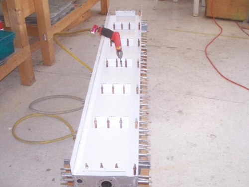

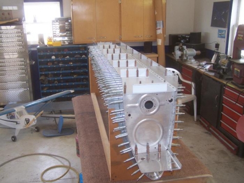

Today I clecoed the T-1002 tank baffles and T-1012 tank attach zees to the tank rib aft flanges and final drilled them to #30. Next I clecoed the baffles to the skins and final drilled all those holes to #40. Finally, I drilled all the screw holes in the skins to #19.
Final drilling the tank baffle and zees to the spar rear flanges.
Baffles and zees installed and everything final drilled.
