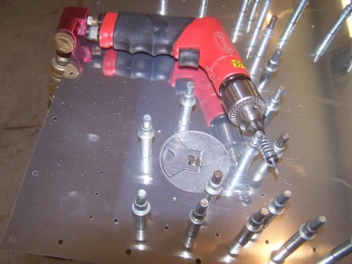

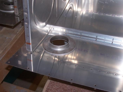

Completed step 3, 4 on page 18-3 and step 1 on page 18-4 (except for priming). Started by bending the flanges on the T-406B fuel cap flanges to fit the wing skins. Then I match drilled them to the skins and attached the T-1008 vent clips to the forward most holes on the flanges. Next I clecoed nutplates to all the T-1012 tank attach zees and final drilled them to #40. Then I removed the nutplates and countersunk all the zees for AN426AD3-4 rivets. Then I deburred all the holes on the zees.
Bending the fuel cap flanges to fit the skins.
Match drilling the fuel cap flanges to the skins.
Final drilling the nutplates on the tank attach zees.
