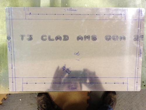

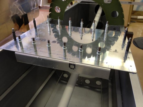

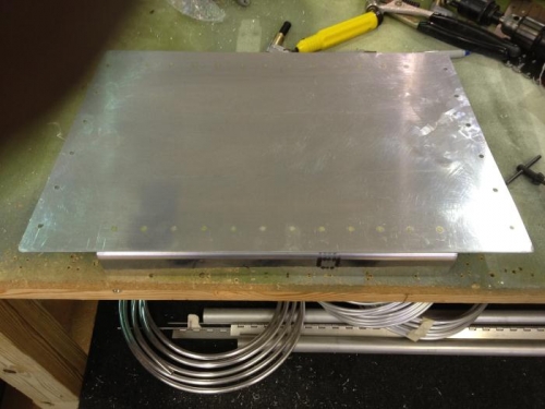

Fabricated ADHRS again from measurement and fitting. I was also not able to locate and plans for this. I was EXTREMELY please with the result, it looks like an exceptionally professional install if I do say so myself!
+ Fabricated ADHRS Mount from stock.
+ Layed out and drilled screw/rivet holes
+ Countersunk nutplate rivet holes in fuselage and sheet
+ Riveted Support Angles to mount
+ Riveted Nutplates to fuselage
+ Primed Mount
+ Installed ELT Bracket in fuselage!
Everything layed out... this took a LONG time, but I didn't want any problems!!!
Everything drilled and cleco'd in place
Stiffeners riveted on, ready for priming.
