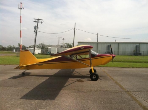

Date:  09-15-2017
Number of Hours:  3.50
Short Description:  ELT
Put fuel in tanks, run engine and taxi plane to wear in brake pads. Transponder set off ELT. Relocated ELT to under forward baggage compartment. Did fuel power static rpm check = 5,640rpm. Added 1deg of pitch to prop (20deg to 21deg) and static full power run up is now 5,250rpm.
